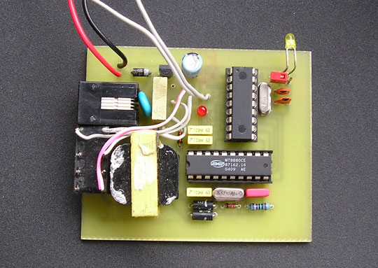

After programming just supply power to the device. After pressing the button "Pokreni dojavu alarma" it will start to dial (tone or pulse, depending on the jumper setup). When the phone call is succesfully established, the called party should press pound key "#" to stop the device from calling another number or again.
