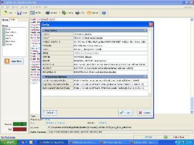

Hi all
after some little problems in material dispatch, finaly something it´s work....
Hoewever i cannot by my FLYPRO, USBASP,POLOLU programmers , concerning you fuse recomendations put the watch working well.
it´should be use CKOUT enabled, and it is.. it´should be use 12 Mhz crystal oscillator, and it is...but after turn on power , nothing is apeear me.
Only work when i use the folow fuse configuration(see attach).
All the watch numbers appear me right , but the led´s no show up, weither the buttons no any interation.
Can you please have the right configuration?
probaly fuse configuration problems...
Best Regards
Best Regards
- AVR Fuse Calculator for ATmega328P.JPG (24.7 KiB) Viewed 11203 times
Re: Warm Tube Clock sat v2
I can't see details in your image, it is too small.
You should also disable DKDIV8 fuse (turn it OFF).
If your LEDs do not turn ON, maybe you didn't solder all pins of TLC59401 completely?

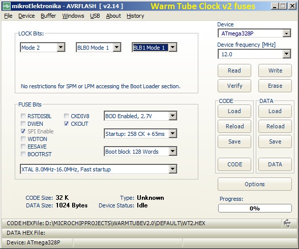

Hi Trax
I can confirm you , my crystal 12 Mhz is perfect, was oscilloscope analyzed...
Please can you see my attach file, and this is my "working" fuse configuration, can you please attach you screen fuse configuration?
Another question is : if nothing can doing with my "tools", can i order you a Atmega328 programmed, instead buy a Mikroe tool?
Best Regards
Best Regards
Here are my fuses for programming.
I don't have AVRs to sell, sorry
Let me know if it helps. Please go one by one and compare!
