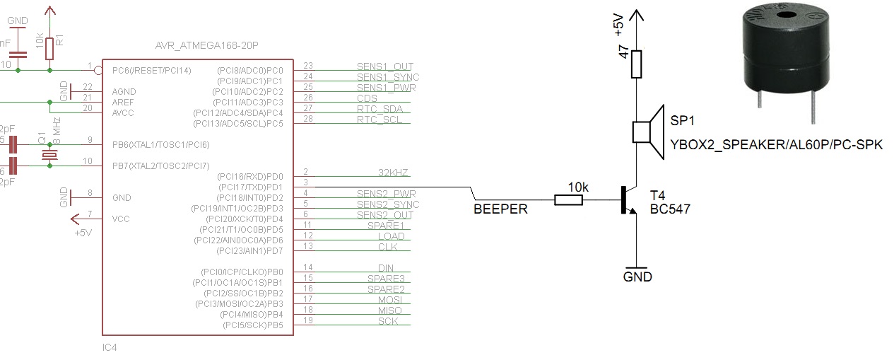

Here is the hardware you can add for the Alarm function so you can finish your clock for now. Later, when I get the time or if someone else adds functionality in firmware, you can just re-program your Atmel and have the alarm function.vszabi wrote:Unfortunately, I can not program in C language, which is why I asked for help. Thanks for the tip, but if some one could also apply to parts that alarm clock, you can not get along with those tubes hour project.
Can you help?
The menu should poke it to build up the alarm function ... I take it?
- Alarm addon - hardware only
- (103.7 KiB) Downloaded 4 times
Re: Construction of Word Clock v1
trax wrote:Here is the hardware you can add for the Alarm function so you can finish your clock for now. Later, when I get the time or if someone else adds functionality in firmware, you can just re-program your Atmel and have the alarm function.vszabi wrote:Unfortunately, I can not program in C language, which is why I asked for help. Thanks for the tip, but if some one could also apply to parts that alarm clock, you can not get along with those tubes hour project.
Can you help?
Hello!
I do not think we understand each other perfectly. (Not a hardware implementation of the Program the problem is I do not know C language..
I thank you for the connection, exactly how I imagined.

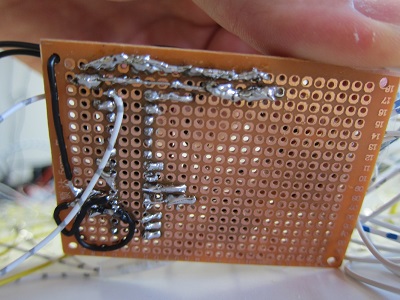

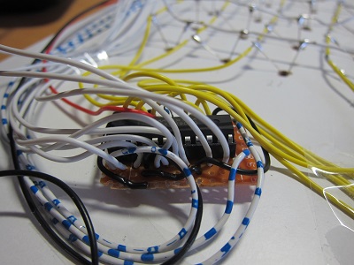

What i always find weird is that every time I restart the clock the text works perfect,
I will upload some pictures of the back of my clock.
What accident report ocj fault would it be? Anyway, i cant see any repost, it just dies and never come back on track, until i restart the clock. I have not lid, its an open back since I just want to learn and try and see if i can do it before i do a proper one. And the pcb (dont know the reall name, what its called) it all soldered on is also not the best, but i have been running with my knife to be sure there is no connections between the lead where is not suppose to be connections.
What translation do you have? I followed the one here and its schedules, and it works out ok for me, so im not sure if it would help, but yes, it would be nice, i can have a look.
Is it possible to send it here at the forum?
I used shielded cables 0,25mm. I cant see anywhere where it would be possible to short cut them, Because i guess its between the LED you ment it could be shortcutted, or where to the MAX?

- Max7219 no 4
- IMG_9434.JPG (61.67 KiB) Viewed 14263 times
- Atmel 328P under - 2
- IMG_9433.JPG (68.59 KiB) Viewed 14263 times
- Atmel328P under
- IMG_9432.JPG (73.05 KiB) Viewed 14263 times
- Atmel328P
- IMG_9431.JPG (66.83 KiB) Viewed 14263 times
- Back side
- IMG_9430.JPG (84.56 KiB) Viewed 14263 times
